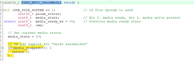

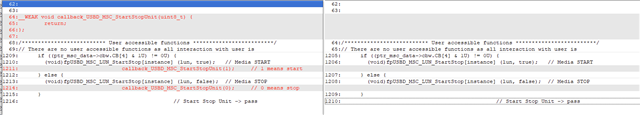

    Changes in usbd_lib_msc.c

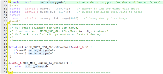

    Changes in USBD_User_MSC_0.c
    Usage: once USB  MSD is initialized and ownership is set to USB, the firmware checks cyclic:
    for(;;) {
        uint32_t mediastatus;
        osDelay(100);
        mediastatus=USBD_MSC0_CheckMedia(); // blockierende funktion!!!
    			if(mediastatus==0) {
    				printf("media status: %d\n",mediastatus);
    				USBD_Disconnect(0);
    				osDelay(20);
    				USBD_Uninitialize(0U);
    The function USB_MSC_Medium_Is_Stopped()==1
    I use to switch off some LEDs in case the device is stopped.
