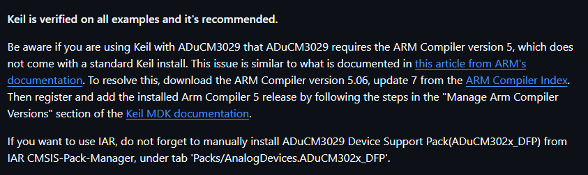

I am trying to run some example code for the AD5940 eval kit on Keil from this repo: https://github.com/analogdevicesinc/ad5940-examples.
They recommend using Keil, so I installed Keil for evaluation purposes.

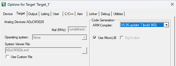

As described above, I installed ARM Compiler version 5.06 update 7 successfully in Keil.
When I compile the code with the v5 compiler, I get 7 of the following error:
`Error: C9555E: Failed to check out a license.`
How can I resolve this? I'd really like to be able to use Keil to evaluate both the board and Keil, but seems like ARM v5 is not supported.
