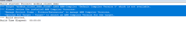

In one of my project I required V5 arm compiler I have downloaded Arm Compiler 5.06 update 7 (build 960) Win32.zip file
Installation of setup.exe is done but to add dd the compiler path in Project → Manage → Project Items → Folders/Extensions we need to add bin file but no bin file after installation. How I can resolve this issue
Arm Compiler 5.x is very old, and is no longer installed by default with Keil MDK.
Please see the below article for the solution:
https://developer.arm.com/documentation/ka005073
If you possess a User-Based license (UBL) and you require the Legacy product Arm Compiler 5, please refer to section B of this article
"User-Based Licensing (UBL), Keil MDK, Legacy, Arm Compiler 5: An Overview..."
https://developer.arm.com/documentation/ka006456/latest
