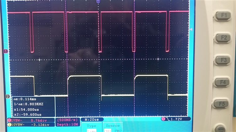

Newbie with ARM, trying to do some example on GPIO. My ( manufacture demo from Keil) code is toggling 3 bits on PB port and one on PA port, the PA4.
For the PB port resulting outputs it is 50%, as usually, with freq depending only on defined delay time.
Why is the PA behaviour different than PB it must, it should also be 50% but it is not.
The RED curve in scope screenshot above is PA4 output signal, Yellow is PB.
The code:

I have to say this is strange, how is that possible? Something new for me was that port must have clock enabled, but it is done.
Whats is going on here?
