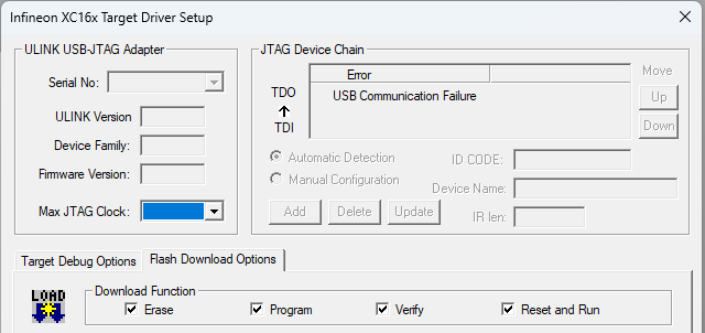

I ve got an upgrade on my PC from Windows 10 to Windows 11. After the Upgrade was completed the Ulink2 Debugger is not recognized anymore by µVision V5.25.3.0. Before The Upgrade Everything worked fine. The Debugger get recognized by Windows 11 as "Keil ULINK2 CMSIS-DAP". µVision itself throws an error "USB Communication Failure".
The Troubleshooting guide is not really helpful as it says "USB Communication Failure USB communication is lost or corrupted. Unplug ULINK2/ME from the USB port and plug it back in."
I was not able to find any logs regarding µVision and Debugger initialization / Startup / anything. Ive Tried to use the UL2_Configure.exe tool from the C166 package to get any confirmation that the Debugger is responding to anything. This worked well and the UL2_Configure.exe was able to update the debugger configuration. After that, µVision displayed the same error message as before.

Are there Any steps I can do to get things running ? Or is it possible to get any logs to dive deeper into the problem ? The Debuggers are recognized by my colleagues which also got the windows 11 upgrade so they are not broken.
