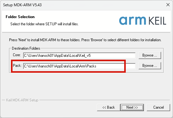

  • The MDK installer lets you choose the destination folders for the core files and the pack file. By default, this is:
    Core:  C:\Users\<username>\AppData\Local\Keil_v5
    Pack:  C:\Users\<username>\AppData\Local\Arm\Packs
    What exactly did you specify for these two folders?
    Instead, the pack is expanded in the same folder as the installation executable (MDK543.exe).
    Which would usually be your 'Download' folder? I did not see this myself and so far no other customer has reported this behavior. Can you duplicate this behavior on a different PC?

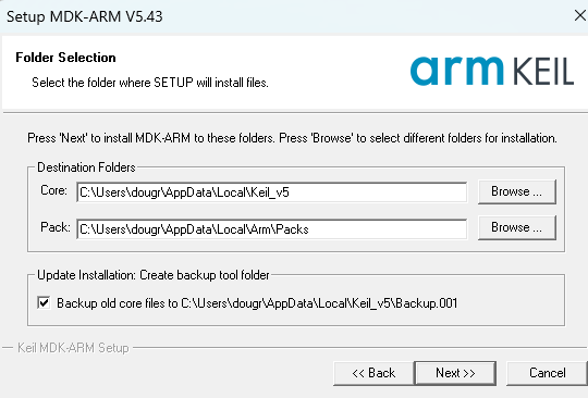

  • Hello Hans,
    Thanks for your reply.
    I used the default folders:

  • Hello Hans
    - I accepted the default folders.
    - The installer (MDK543.exe) is located in C:\inst\Keil\Community. In my case, Packs was unpacked there.

  • You are right, I can duplicate this problem here as well. Our MDK v5.43 installer does not expand %LOCALAPPDATA% correctly.
    However, there is an easy workaround: You just need to touch the Pack-path. As soon as you modify this string, the installer will work. Even if you want to use the default path, you could delete the 's' at the end of the Pack-path and then add it again before you press the 'Next' button.
    We plan to fix this issue in an MDK 5.43a version, which will be released in a few days.
    I'm sorry for the inconvenience.
