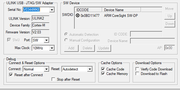

Now I wanted to use the SWO trace, but CMSIS-DAP does not support that as an option. I switched to ULINK2 as a debugger probe in the configuration and the flashing works fine, but when I try to debug the application, it enters the debug state without any errors and it does not work. What I see while I am in the debugging mode is that no info are shown in the system and thread viewer after a reset. When I start the debugging session while the micro is running I see the correct information, but they are not updating (I have the periodic window update enabled) and lose everything if I reset the micro.
CMSIS-DAP configuration:
ULINK2 configuration:
Can I do something to make the ULINK2 work?
