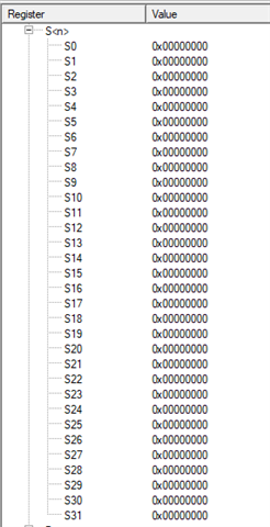

I am trying to run a fpu instructions on STM32H503CBU6 microcontroller. When I check the values on the FPU registers, it remains 0x00000000 with respect to the particular S<n> registers that I'm trying to use.
Please see the snapshot below.
