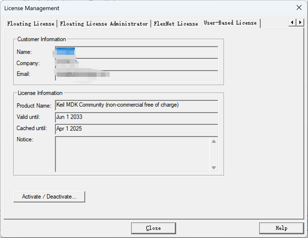

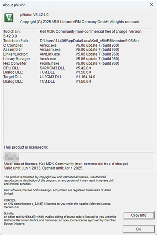

Thank you very much for your answer. I confirm that I have completed the activation of the software, as shown in the screenshot below. The compiler I am using is version 5.06. Not the default version 6.0. Could it be because of this issue?
Yes, that is the issue. The community edition license only enables Arm Compiler 6.
Arm Compiler 5 will be in the default (legacy) evaluation mode, which is limited to 32KB.
