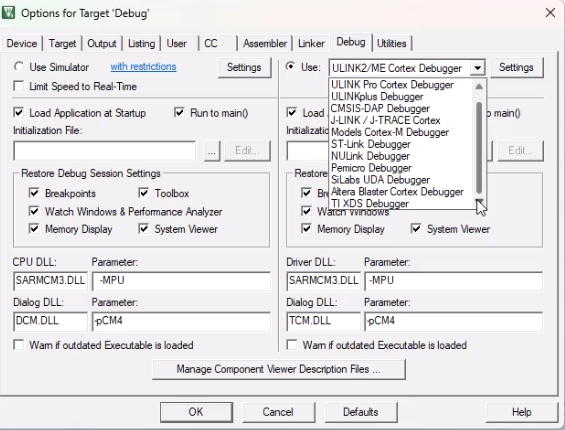

Hello everyone,

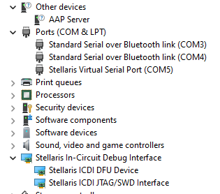

Thank you for taking time to read this query, I have a question regarding dependencies for Keil MDK and Stellaris ICD drivers for Windows 11, and unfortunately, I am so far not successful in flashing the software as it is not showing up in the debug options.
Is there any way around with this for now? or anyone has experienced similar issues with it so far in Windows 11?
Note: I have installed the add on installer
Any suggestions or feedback on this would be deeply appreciated!
Tools and Version : Keil Mdk 5_41
Development Board: Ti Tiva c series launch pad TM4c123gh6pm
OS: Windows 11
debugger options in mdk
Stellaris drivers showing up on Windows device manager
