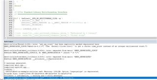

Hi, my MbedOS Project did build with MDK 5.30, however with 5.33 the vrey same source does not build anymore.Same numbers of warnings, but an error saying multiply defined. What's also interesting, the view of the source code isn't grayed out in uVision.
Build view with MDK 5.33
Build view with MDK 5.30
Thanks a lot for your support, Adrian
This page might help you further:
https://www.keil.com/support/docs/4156.htm
After upgrading the IDE, you might think you are building the exactly the same code. But keep in mind that a few software packs, such as CMSIS pack, are updated with a newer MDK version
