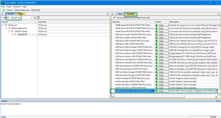

Also, there is a demonstrating example project prepared for the STM32F746G-Discovery:
Note:
