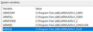

Before uVision , i have used "CodeWarrior for ARM Developer Suite". I saw that in the environment variables -> System variables that
is the same that appears in the warning below:
Warning: L6373W: libattrs.map file not found in System Library directory C:\Program Files (x86)\ARM\ADSv1_2\LIB\armlib\. Library selection may be impaired.
How could I fixed it without uninstalling "CodeWarrior for ARM Developer Suite"?
