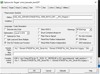

Okay another update
I defined ARM_MATH_CM7 and __FPU_Present 1 in the compiler command line however I am getting macro definition error now
it is doing this for pretty much every file I have in my project including CMSIS DPS files
my compiler command line looks like this
PLEASE HELP ME
You have a space between __FPU_Present and 1. Check the syntax for macro definitions (the -D switch) -- you need an equals sign.
