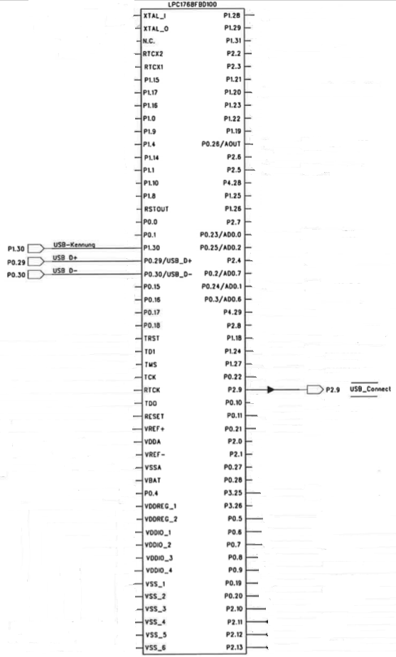

Pins 1.19 and 1.22 (USB host config) are not connected:

At the moment, if USBD_Initialize() and USBD_Connect() are placed before any of the previous threads, a new COM port is created but the remaining threads
fail to launch. If placed after thread creation, no COM ports are created.
