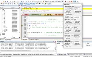

My program hangs after some seconds before using a thread for "netInitialize();" function. After adding a new thread for netInitialize() (Job3) it shows me this fault window:
In my point of view, my STM32f107 and DP8384 communication for sending each 100us a UDP package have a problem and it causes that the netInitialize(); halted. because I can't see any other problems.
Halted just means that you've stopped (ie, "Halted") it in the debugger!
