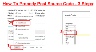

Copy & paste the full, unabridged build output, and show the section of source code where the error is reported.
(for the build output, just use steps 1 & 2).
