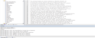

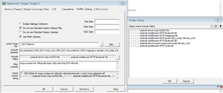

Now my project seems only see the 1st library, but complains can not found other libraries. I've add all other libaries include path .I am use mt2523 chip. I've also add all libraries(.a file) to my project.

What I want to do is mtk just release one lib that is built using gcc, and will not release the armcc version. And I want to use this gcc library, but encount this issue.
Yes, if I take the 1st library out from the Option->include libraries, then it see the second.
Ok, so probably want to decide if you want to add the libraries to the project, OR put them on the command line, not sure I'd do both.
