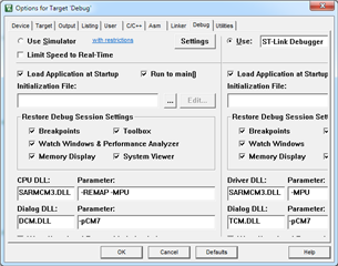

With UV4.exe the resource dialog fonts are a mixture of (mostly) "Microsoft Sans Serif" and "MS Shell Dlg". "Microsoft Sans Serif" expands to about 50% larger than "MS Shell Dlg" and so the dialog gets truncated or the right half is not visible. I can't edit the debugger settings without editing the uv4.exe resource and changing the font. This is on windows 7 with scaling set to 100%.

thanks for reporting this. Which MDK version are you using? The latest one, v5.28a? Since when do you have these problems?
I would suggest to contact our support via support.intl@keil.com so that the right people can take a look at this.
