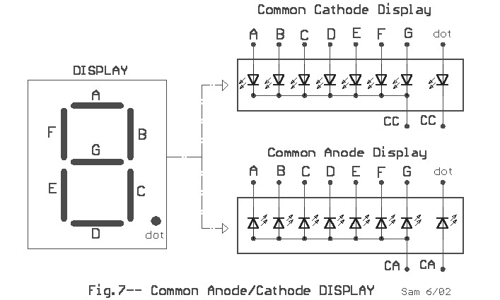

The illustrations of "common anode" and "common cathode" in that last link are broken; see this one instead: www.rlocman.ru/.../~athsam-Circuits-SG_Clock-SG_clock_display_conn.gif
