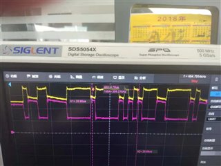

I wrote it with reference to http://www.keil.com/pack/doc/CMSIS/Driver/html/group__can__interface__gr.html
Such waveforms have appeared before, but the program has been modified
The signal is sent in a loop, which I don't think is correct
Who CAN give me an example of using CAN module correctly to send the simplest message (code that CAN be reused)?
