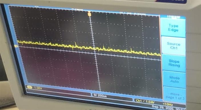

while debugging we observed on each and every pin of JTAG in oscilloscope then we found that TDO pin is 0.5v continuously when connected to DSTREAM debugger.

TDO: 0.5V 0.5V
