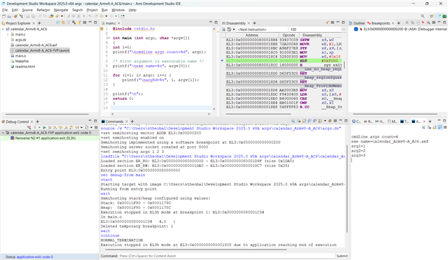

    The same setup works for me with the Neoverse N2x1 FVP model - see screenshot:
    Have you set the Model Parameters correctly?  They should be
    -C cluster0.NUM_CORES=1 -C bp.secure_memory=false -C semihosting-enable=0
    I can reproduce the crash that you see if I remove the last two parameters.
    Stephen
