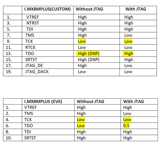

These are the values we had observe in Oscilloscope.
The above for I.MX8MPLUS EVK and I.MX8MPLUS Custom boards ,here we are using Coresight 20 pin JTAG .

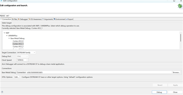

After connecting tried to debug in debug configuration  we are unable to connect the board through JTAG(Coresight 20) .
For both boards I.MX6 and I.MX8MPLUS we are using same tools and software(Arm development studio and Dstream-ST) .

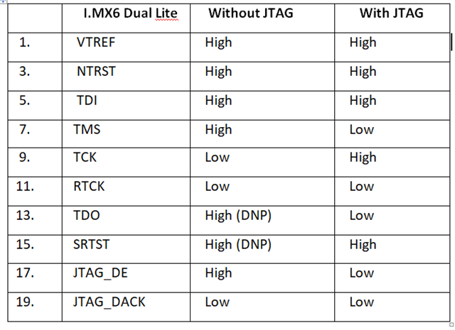

For I.MX6 Dual Lite we are connected successfully to the target through JTAG(DSTREAM-ST) .

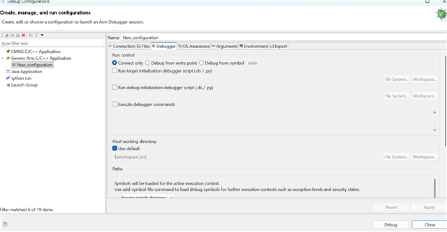

In debugging tab we enabled Connect only  after that click on debug. We are getting failed to connect to any devices on the target. Check that the target is correctly connected to the debug probe and powered on.
