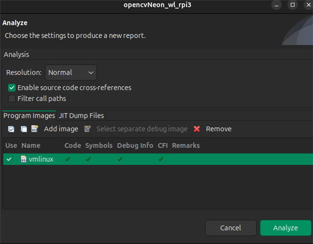

I managed to get a capture with some of the functions I added to the Linux kernel but when I double click on the function it doesn't show anything in the code section (just empty table). When I attached my userspace program it worked fine and I could see the source code in the code section.
While creating the capture, I attached a debug vmlinux file as mentioned in "streamline/gator/README.md" file.

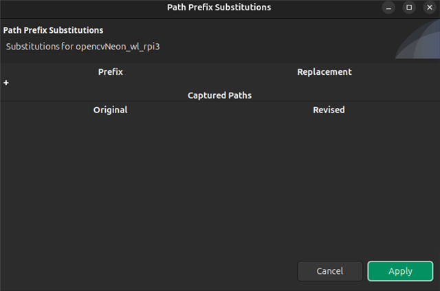

I'm analyzing a system running on Raspberry Pi 3 B+ with a custom Linux image based on Buildroot. I'm adding below some screenshots for my capture.
Note that the function "cv_neon_read" is part of the code I added to the linux kernel but when I double click on it, it doesn't show in code
Is there something I need to do to enabled the kernel code to be visible in the code section?
