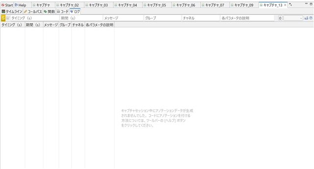

I am trying to capture atrace data from an Android device using the Arm Streamline Performance Analyzer.
But I cannot find any atrace data. The log view also shows no output.

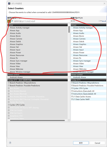

-In the "Select Counters" settings, I also confirmed the atrace events are enabled.

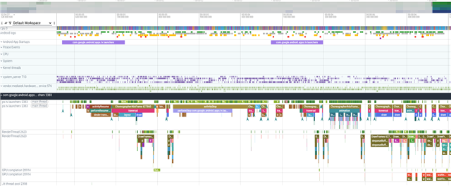

-When I capture trace data using Perfetto, I am able to obtain the atrace events, indicating that atrace is enabled on the Android device.

    We tried to debug the capture you have provided and looks like it has no atrace events captured.
