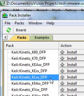

Have you tried installing the appropriate software packs in uVision? From v5.12 onwards software for all devices is no longer installed by default and required software can be downloaded by using the pack installer: from the Project Menu --> Manage --> Pack Installer...
From here you can select the support files for your chosen device.

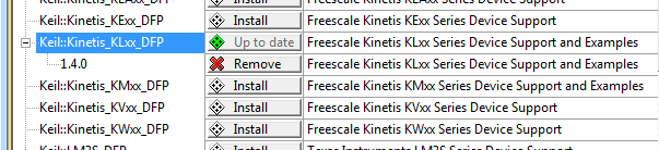

Yes I already installed Kinetis KLxx_DFP pack like yon can see below :

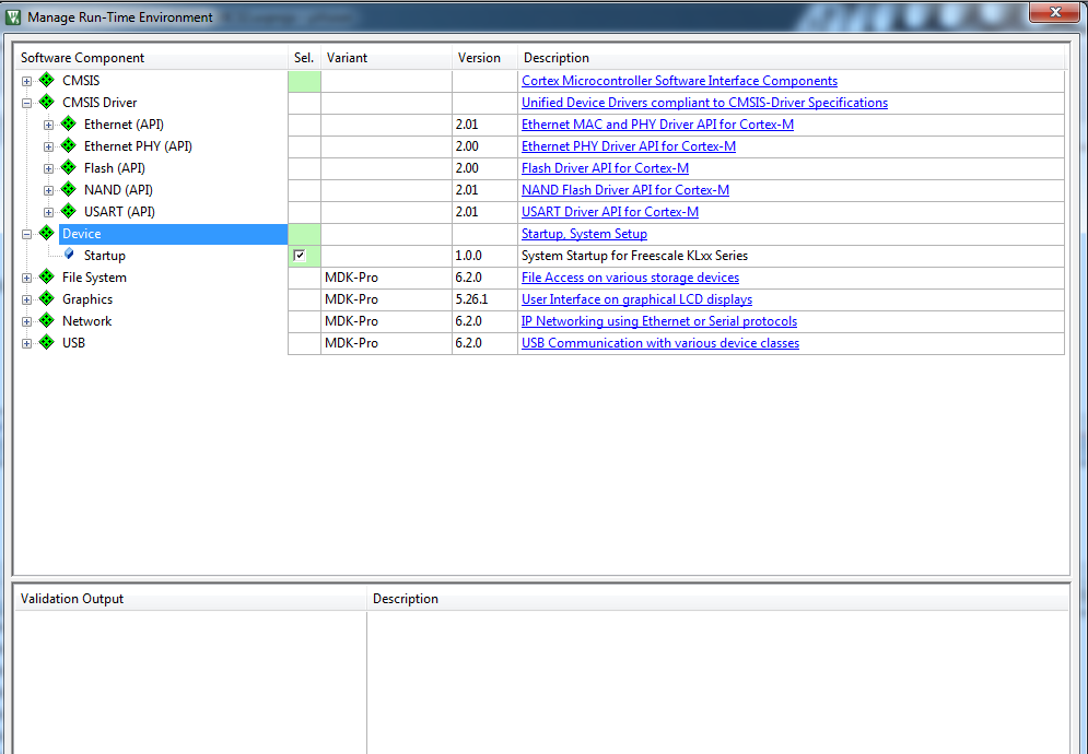

It's just Unlike other vendor (ST, NXP and more), it seem that Freescale CMSIS driver are not completely present for KLxx family... But maybe I'm wrong so that why I ask it here .

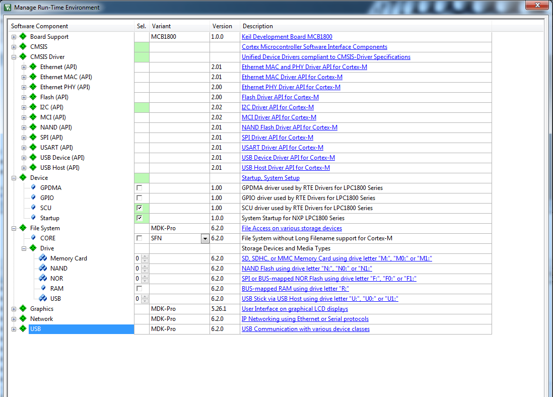

Look by yourself :
Freescale KL25Z :
NXP LPC18xx :
There are so much more interesting thing with LPC18xx. I'm pretty frustrated.
Hello 0zmax,
unfortunately, there are no CMSIS-Drivers available for Freescale devices at the moment. In the meantime please use the drivers from the latest Freescale SDK as shown in this video: http://www2.keil.com/freescale/
Kind regards,
Christopher
