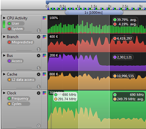

By MCPS, I'm assuming you mean frequency?
Streamline has a counter for the clock, which can give you the overall frequency that the core is set at, as well as the number of core clock cycles:

Would you be able to describe your problem in greater detail for me please? Are you able to see the Clock chart (like my screenshot above) in Streamline?
Thanks,
Hi Joe,
Yes am able to see clock chart shown by you.
i need to calculate MCPS (Million Cycles Per Second) for my program using Streamline. The clock chart gives MCPS figure, but we need to know how did it arrive at that figure? In functions tab, its showing self samples. How is this used to calculate MCPS?
Streamline arrives at this figure by tapping into the Performance Monitoring Unit hardware counters of a processor (see here for a functional description of the PMU on a Cortex-A7 as an example): PMU functional description
In other words, it's sampled directly from the hardware.
Thanks for the response. How is self samples related to clock cycles?
No problem. Since Streamline is sample based (you decide how often you want Streamline to sample, up to 1 ms accuracy), it periodically checks which function a program is in and reports back. This allows you to see where in the code a system is spending the most time.
Streamline also periodically samples the PMU to collect a value for clock cycles, so what you see is a representative value.
