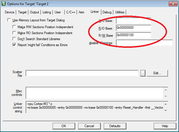

    The issue above is a linker error, and is caused by the default settings from MDK, when a specific MCU is not used. Click on the 'magic wand' Options icon (or Alt+F7), and navigate to the Linker pane. You will see settings for locations for RO and RW code, which default to 0x0. Relocate them (for example I moved RW to 0x100), and the code will build.
