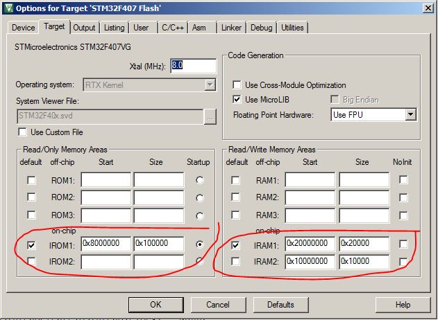

    Selecting Options for Target (Magic Wand icon or Alt-F7) and select the Target tab as shown below:
    The left side is the memory (Flash or RAM) where your program will be stored  and the right is for variables etc. This example is for the STM32F407 processor.
    Create your program and variables and so on - and the Linker will allocate these in memory accordingly.
    You can click on the Linker tab to see where the scatter file can be selected.
