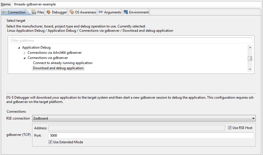

I assume you are performing a gdbserver "Download and Debug Application" type debug session?
Have you created an ssh connection in the Remote Systems Pane? You can then specify this in the RSE connection in the Connection pane, such as:

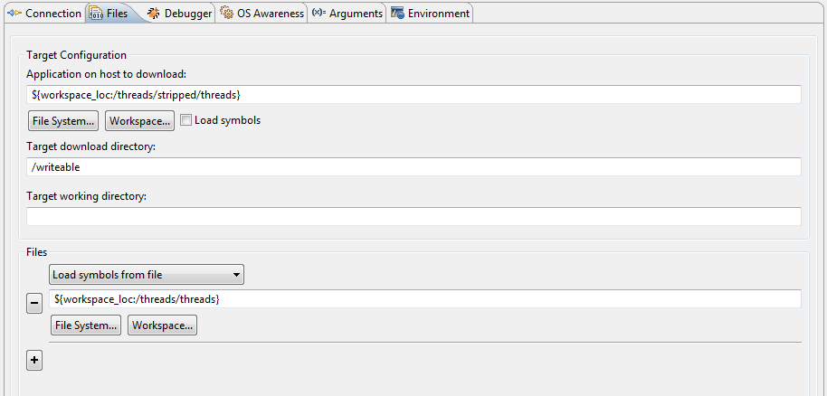

Then in the Files pane, specify the location (relative to root)

Under "Files" tab, I have under "Application on host to download" Y:\Projects\brwatson-ubuntu\packages\test\bin\test.elf

As I was typing my reply, I noticed my error! I was using \home\directory instead of /home/directory. As always, java exceptions were "useful" in not finding the actual error.

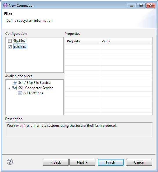

When you create the remote system configuration, click next, then select ssh.files in the upper left (ftp.files is the default)

Under "Remote Systems", add a new targetSelect "SSH only"<next>Hostname: 192.168.1.148Connection name: PU
<next>Under configuration: the only option is ssh.files; available services shows ssh/sftp file service, ssh connector service; ssh settings
