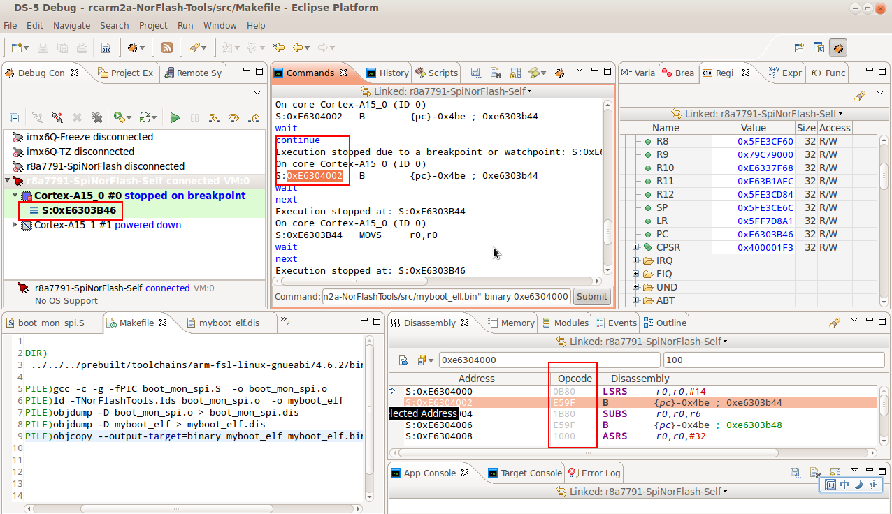

  • Thanks. And I meets some problems. The auto configure of dbghwconfig configured the target partly.
    Below is the Disassembly window snapshot, you can see that each instruction is 2 bytes instead of 4 bytes.
    I have query the Memory window, the data is right. And all these address is in SoC intern RAM. The load/restore is OK, and I can stop the SoC.
    And other:
    And other:
