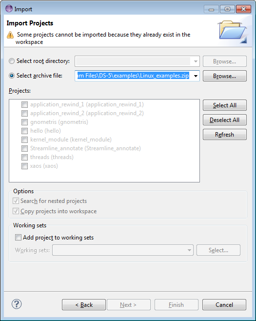

    Are you trying to run it on the included FVP model? The best way to start would be to (first switch to DS-5 Debug Perspective by clicking Window > Open Perspective > DS-5 Debug) import the included Hello World example program by right clicking in the Project Explorer view, selecting Import... and then General > Existing Projects Into Workspace.
    Now navigate to the DS-5 folder where the example Linux projects are contained:
    Tick Hello and then click finish. That will import the example.

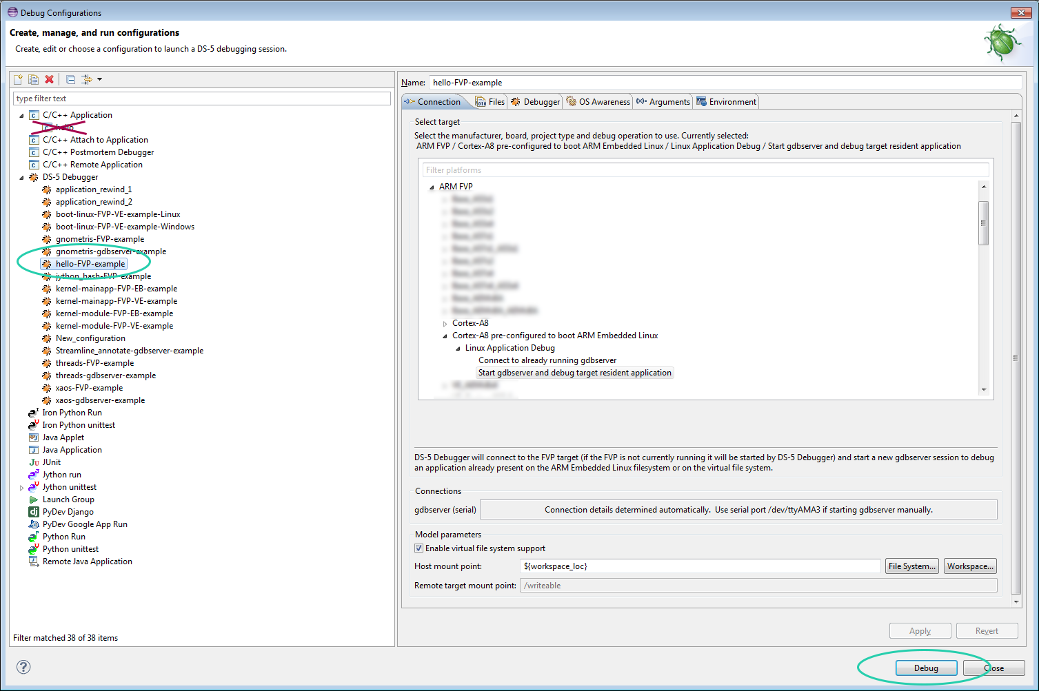

  • Hi,
    It looks from your error message like you might not have launched the debugger from the DS-5 Debug Control view, instead, it looks like it was trying to run natively on your machine - this won't work. My colleague has just tried this on his Ubuntu machine and can reproduce the same error by trying to run the hello executable natively.
    Rather than opening the hello project in project explorer and trying to debug the stripped executable simply by clicking the debug button, you need to run the debug configuration to make sure that the FVP gets launched.
    Open your Debug Control view and right click inside it, or select the arrow next to the debug icon. Select Debug Configurations...
    Now, select hello-FVP-example which is located in DS-5 Debugger (this is preconfigured to just work) and click Debug:
    It should be exactly the same in Ubuntu. The only other possible thing that you might want to check is that if you installed the 64-bit version, you have included the 32-bit compatibility libraries.
