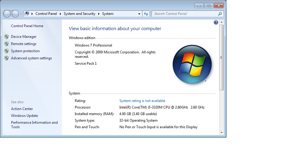

  • Windows7 - the detail information is attached.
  • My configuration information is in 2nd column of the table
