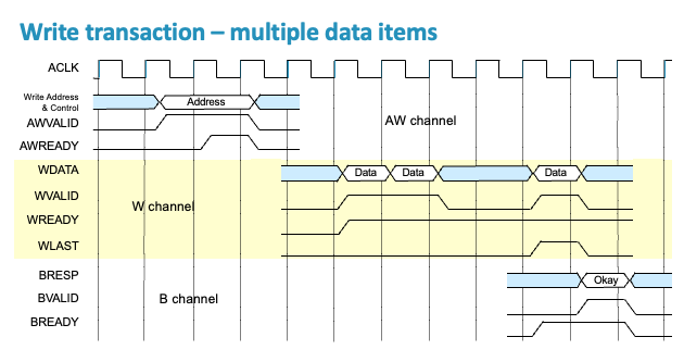

    AxVALID indicates the information on the Ax bus is valid, and that the manager interface is attempting to issue this information downstream.  AxREADY indicates that the subordinate can accept the information, and a transfer will occur when AxREADY and AxVALID = 1.
    This means that for a single AXI transaction, AxVALID will be 1 until the information on the Ax bus is transferred - when AxREADY = 1.  After this point, AxREADY can be either high or low - it depends on whether the subordinate interface could accept another transfer.  AxVALID will be 0, unless the manager interface wishes to send another transaction.
    See the example below:

    I'm not quite sure I understand this question.  Potentially the example above clarifies this?
