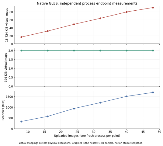

Interleaving retained 200 x 300 full-mip image uploads with two sequential 1536 x 3072 RGBA8 temporary texture create/copy/delete cycles per frame reaches about 2,098 MiB Graphics after 56-58 images. Images are uploaded every 24 frames. Fixed blur render targets are reused. The attached source includes the exact GL/EGL command ordering and a monitored runner.
Two fresh-process repetitions per control show:
- No temporary-copy turnover, including repeated recent fence waits: about 125 MiB peak at 160 images.
- Turnover plus full mips: about 2,097-2,099 MiB. CPU-generated mip levels also reproduce this.
- Same CPU-mip program with mips disabled: about 168-171 MiB at 160 images.
- Retain at most 20 images: about 871 MiB at 160 uploads.

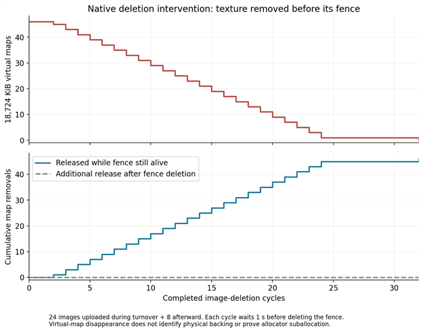

Timing matters: preloading images, waiting before uploads, or finishing every frame prevents most growth. However, after growth has formed, idle/completion waits do not release the main retained amount. Deleting image textures releases memory in steps while their explicit fences are still alive. Same-context uploads and a no-explicit-fence variant also reproduce high retention. Full mip state behaves differently from a level-0-only texture with approximately equal logical bytes.
Additional controls falsify a timing-independent block-pinning model: at 48 images, preloading gives about 141-142 MiB, interleaving about 1,787-1,805 MiB, and finishing both contexts plus waiting one second before each upload about 136 MiB. A 32-image approximately equal-byte level-0-only control is about 118 MiB versus 1,237 MiB for full mips. After retention forms, a separate 60-second idle run remains around 1,675 MiB.
Two texture/fence deletion controls each release 46 large Mali virtual mappings while fences remain alive, with zero additional large-map removals at fence deletion. Maps are virtual, not physical residency. Frequent maps observation itself suppresses the growth, so later high-growth measurements use endpoints. We have not established a permanent leak, specification violation or physical allocator mechanism.

gles-reproducer.ziparm-native-evidence.zipIndependent native endpoints: image count versus Mali virtual mapping buckets and Android Graphics; virtual sizes are not physical residency.P2 split deletion: large Mali mappings disappear after image texture deletion while explicit fences remain alive; two repetitions.
