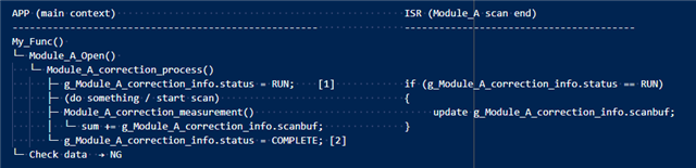

g_Module_A_correction_info is shared between the application and the Module_A ISR, but it is not declared volatile. With the same source code and the same -O2 level, the result depends on the compiler version:
  • GCC 13.2: the store status = Module_A_CORRECTION_RUN is kept. The ISR sees Module_A_CORRECTION_RUN, updates scanbuf, and the correction data is correct.
  • GCC 15.3: the same store is removed as a dead store, because status is overwritten with Module_A_CORRECTION_COMPLETE later in the same function. The ISR never sees Module_A_CORRECTION_RUN, never updates scanbuf, and the correction data is wrong.
Flow code:
[1] is removed by GCC 15.3 -O2. Only [2] is emitted, so the ISR always reads COMPLETE.

  • Hi,
    It is hard to be certain given the information you provided, but it sounds to me like GCC 15.3's DSE believes 'status = Module_A_CORRECTION_RUN' is 'dead', i.e. irrelevant. In your flow code image, if GCC doesn't think status is read between [1] and [2] then it rightfully assumes [1] is dead.
