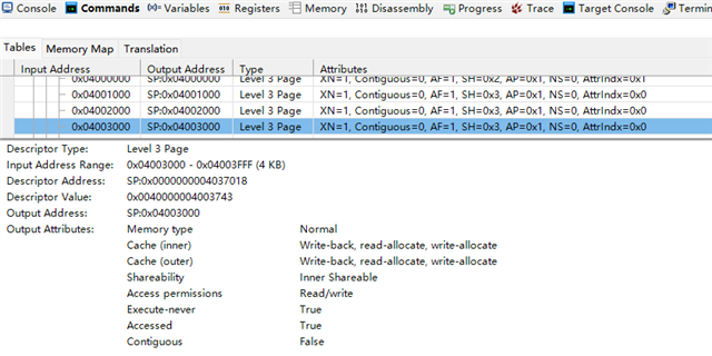

Technical Evidence (Verified via Debugger):
SCTLR_EL3: M=1 (MMU enabled), WXN=1 (Write implies execute-never), I=1 (Instruction Cache enabled).
BL31’s code is loaded at: 0x04003000
Translation Table Entry (L3 Descriptor): 0x00400000_04003743
Physical Address: Verified via TTBR0_EL3 walk. (0x04034600 -> 0x04035003 -> 0x04037003 -> 0x00400000_04003743)
Attributes: AP[2:1]=0x1 (Read/Write), XN=1 (Execute-Never), AF=1, SH=0x3 (Inner Shareable), NS=0, AttrIndx = 0x0 (See the MAIR_EL3)
MAIR_EL3: 0x4404FF (Attr0 = 0xFF, Normal Memory).
Synchronization Performed: DSB SY + ISB
The PC (Program Counter) is confirmed to executing from the first instruction of BL31 code at address 0x04003000.
