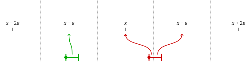

To illustrate this, here is a diagram of a small piece of the number line:
Diagram of rounding some sample division resultsDiagram of rounding some example division results
The labels show numbers that are exactly representable in double-precision floating point. In the center is an arbitrary number x. The values to the left and right change by the “machine epsilon” ε at each step. This is the minimum separation between floating-point numbers with a particular exponent.
The dotted lines, located halfway between representable numbers, show the rounding boundaries. In the default IEEE 754 mode, numbers are rounded to the nearest output value. This may be either rounding up or down. A number just left of a dotted line rounds down, and one just right rounds up.
The green interval on the left shows one possible output from ddiv’s main division code. The actual value returned is the circle at the left end of the interval. The code uses an approximate method. but it only errs in one direction, so the true quotient is never further left than the green blob. It might be further right, anywhere within the marked interval.
Fortunately, it does not matter. The whole interval lies between the same pair of dotted lines, so any value in that interval will round to the same output value, namely x − ε. Therefore, the uncertainty in our approximate quotient does not affect the final output.
The red line on the right shows what happens if we are not so lucky. In this case, the interval crosses a rounding boundary. The smaller values on the left side of the dotted line round down to x. The larger values on the right side round up to x + ε. The correct output value is uncertain. Our fast but approximate calculation has not managed to narrow down to just one answer. In this case, ddiv runs correction code that performs additional calculation to determine the correct output.
