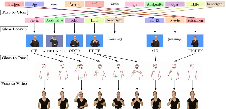

  1. Rule-based approach (illustrated in Figure 2)
    1. This first translates text into gloss by reducing the word to its root form and syntactic reordering and then applying grammatical rules.
    2. The glosses are then used to generate poses using look-up tables. These can then be rendered into animations.
  2. Machine learning approach
    1. Translates the input text directly into Sutton SignWriting, a symbolic written system for sign languages.
    2. This SignWriting can then be converted into pose data and then synthesized into videos
Pipeline of the gloss sign language translation approach.
Figure 2: Pipeline of the gloss sign language translation approach.

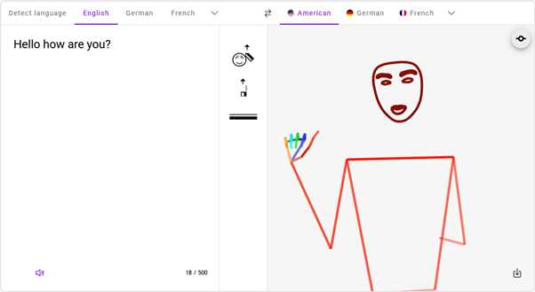

Screen shot of sign.mt's webpage demonstrating their sign language production technology https://sign.mt/
Figure 3: Screen shot of sign.mt's webpage demonstrating their sign language production technology https://sign.mt/

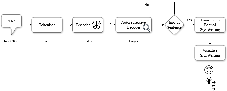

After reviewing the available solutions, we chose to work with sign.mt’s open-source machine learning model for translating text to SignWriting. We aimed to deploy this on mobile. There are many different approaches to sign language translation, including rule-based systems to translate into gloss and then look-up tables. However recent advances in ML mean the machine learning path offered the most potential.
Sign.mt’s work includes many components. For our mobile app, we are using their pipeline for translating text into Formal SignWriting, a symbolic writing system for sign language. The translation model is a sequence-to-sequence neural machine translation system. It uses PyTorch and builds on the Sockeye framework developed by AWS. It features an encoder–decoder architecture with an autoregressive decoder that generates SignWriting characters.
Diagram showing the simplified architecture of the text to signwriting translation model
Figure 4: Diagram showing the simplified architecture of the text to Signwriting translation model
To run the full pipeline the following repository is required:
  • https://github.com/sign-language-processing/signwriting-translation/tree/main
And the dependencies can be found here:
  • https://github.com/sign-language-processing/sockeye
Despite its potential, the current model is limited by the size and quality of the training data. The model is trained on the SignBank+ dataset, curated by sign.mt. This dataset includes community contributions and multilingual sources. However it is small by machine learning standards. This can cause issues with translation quality, especially for complex and unfamiliar inputs. Nonetheless, there is great value in the model and this work will hopefully help future development of sign language accessibility.

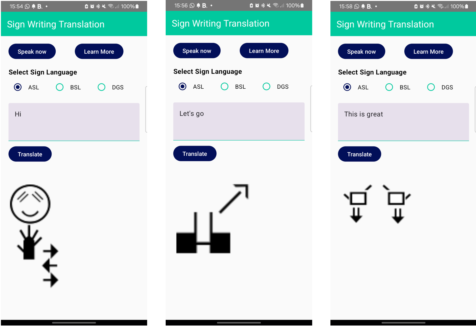

To build the Android app, we ported all inference logic, tokenization, and result visualization from python to Kotlin. Speech-to-text using Android’s built-in API was also added and provided an easy input method. Visualizing the SignWriting is done by creating bitmap images using the Sutton SignWriting fonts. These images appear in the user interface.
The project produced a lightweight mobile app that translates speech or text into visual sign writing. This is an early step forward to building a real-time sign language assistant.
Example screenshots of the signwriting translation app
Figure 5: Example screenshots of the SignWriting translation app
