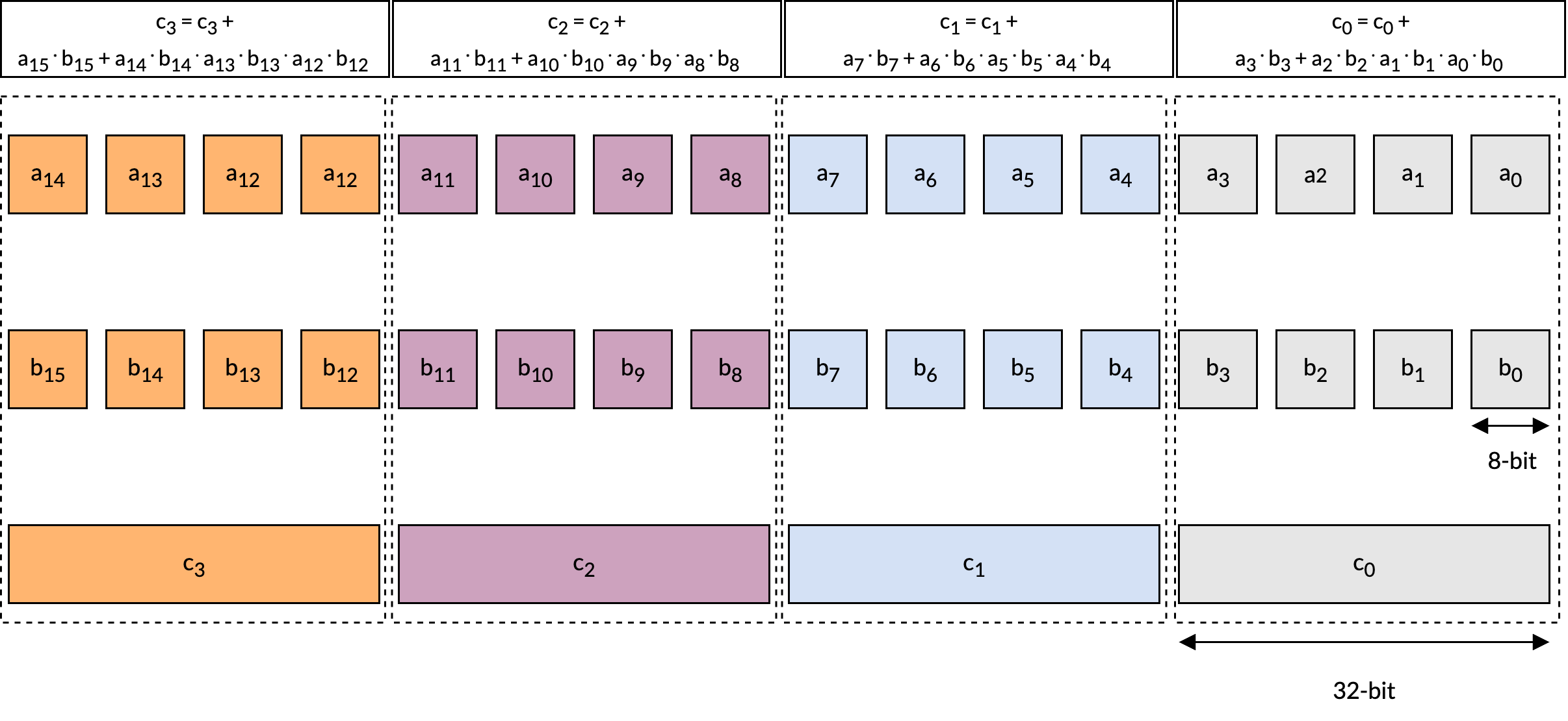

The SDOT (Signed Dot Product) instruction, introduced in the Armv8.2 architecture and later CPUs, enables efficient dot product operations on vectors of 8-bit signed integers. The following image illustrates the behavior of one such SDOT instruction available on Arm CPUs:
Shows the behavior of one such SDOT instruction available on Arm CPUs
As shown above, the instruction produces four 32-bit integer outputs, each resulting from the dot product of corresponding groups of four int8 elements from the left-hand side (LHS) and right-hand side (RHS) vector registers.
This instruction can be utilized to accelerate matrix multiplication routines—the core computational workload behind every LLM—when using Int8 or lower-bit precision formats, such as Int4. These operations typically involve numerous dot products between individual rows of the left-hand side matrix and corresponding columns of the right-hand side matrix.
