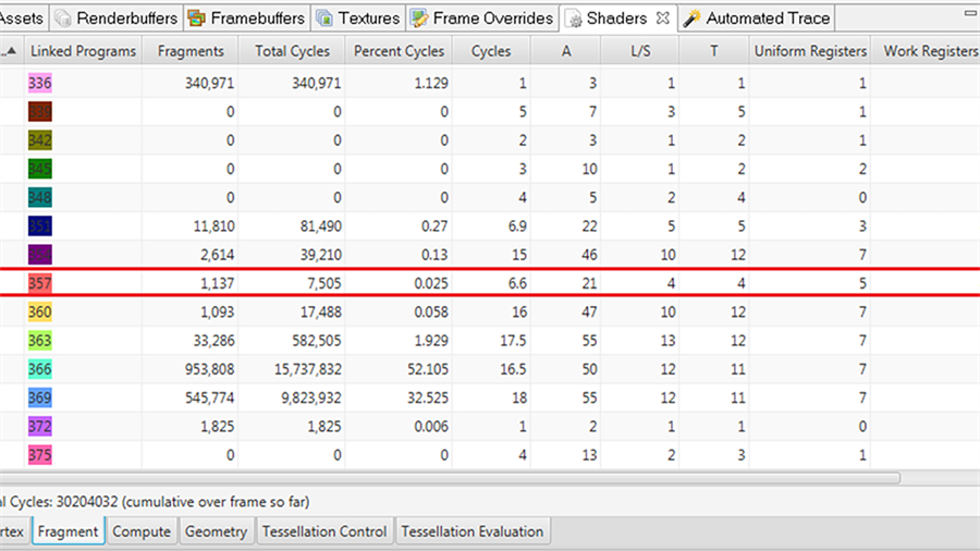

Using the Mali Graphics Debugger
MGD provides the same information as MOC related to shader cycles and register usage, with the added advantage that it intercepts the API calls from Unity and so automatically shows the information for the Unity shader variant actually in use.
Figures 3 and 4 show all the information provided by MGD for the vertex and fragment shaders running on the device. In a previous blog I describe how to build Unity applications with support for MGD.  When capturing an MGD trace, you can click on the button  in the tool bar to make MGD to show the number of fragments that have been rendered with the shader in the current frame. This is needed to allow the tool to compute the total frame contribution of a fragment shader.
 Example of vertex shader cycle and register use output in Mali Graphics Debugger
Figure 3. Example of vertex shader cycle and register use output in Mali Graphics Debugger.
Example of fragment shader cycle and register use output in Mali Graphics Debugger
Figure 4. Example of fragment shader cycle and register use output in Mali Graphics Debugger.
Vertex and fragment shaders are listed with different IDs. To find the fragment shader corresponding to a given vertex shader we should look for the same linked program ID. For example, the vertex and fragment shader framed in red have the same associated program ID.
By clicking on the column header we can order the figures so we can easily see which are the most cycle consuming vertex and fragment shaders at a glance.
At the end of the table MGD displays the total vertex and fragment cycle count for a given frame if we have selected the frame in the Trace outline pane. If the frame is composed by several render passes MGD will display the total cycles accumulated up to the selected render pass in the Trace outline pane.
At this point we can use the total cycle count figure to compare it with our target GPU budget. Nevertheless we need to do a couple of additional math operations. As the GPU budget we have calculated is expressed in terms of cycles/frame/pixel we need to divide the figure provided by MGD by the total number of pixels and finally find the total number of cycles in a frame by adding the figure for the vertex and fragment shaders. If there is any compute shader we need to consider them as well into the sum.
Let’s consider the total values in the figures 3 and 4. The frame buffer resolution used in this capture is 1280x720, it means we are rendering 922K pixels.
     Total vertex cycle count/frame/pixel = 3.49M / 922K = 3.8 cycles/frame/pixel
     Total fragment cycle count/frame/pixel = 30.2M / 922K = 32.7 cycles/frame/pixel
     Total cycle count/frame/pixel = 3.8 + 32.7 = 36.5  cycles/frame/pixel
The total value of 36.5 cycles/frame/pixel is the figure we have to compare with our target GPU budget. If this figure is in the range of our GPU budget then we are not asking to the GPU more that it can give. If it is higher, then the way to proceed is to look at the shaders with the higher cycle contribution and try to reduce their complexity until we get a total cycle value in the acceptable range.
