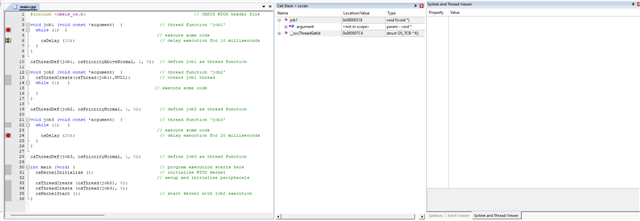

Executing this code with compiler version 6 makes the debugger behave like this:

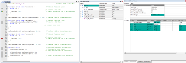

Executing this code with compiler version 5 instead makes it behave correctly (no other settings touched):
