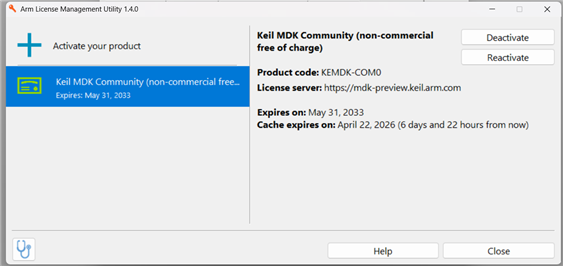

  • checked that the license is active

  • Thank you, that looks fine.
