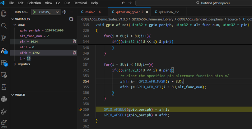

The Local Wactch window is in decimal. How can I convert it to hexadecimal?

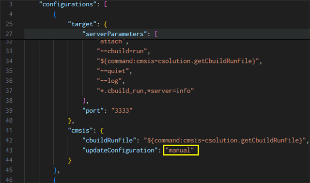

    Please subscribe to follow up on the issue. As a temporary workaround, you can set output-radix in the launch.json file. This will convert all values into hexadecimal:
        "initCommands": [
              "set output-radix 16",
              "monitor reset halt",
              "tbreak main"
    To prevent the setting from being overwritten, remember to set "updateConfiguration" to "manual."

  • Hi
    I tried changing the launch.json file to "set output-radix 16" and "updateConfiguration" to "manual".
    But it doesn't result in a hexadecimal number.
    What's the problem?
    The launch.json file is in the .vscode folder.
    I also have settings.json and tasks.json.
    Is it correct to modify this launch.json file?

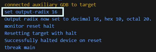

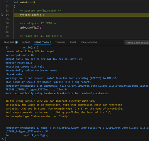

  • On my side this works as expected. And your setting in the launch.json file looks fine.
    Could you please confirm whether you can also see the 'Set' command being called in the Debug Console?  This would indicate that the command is actually being applied by GDB.

  •  Hi
    set output-radix16 is not displayed.

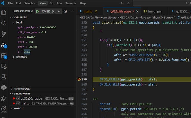

    I tried it today and it displayed in hexadecimal!!
