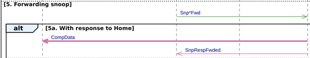

Figure B2.1 in CHI Spec Issue G
The color of SnpRespFwded in Alternative 5a of the DCT flow in Figure B2.1 seems incorrect. Or is it actually sent through the data channel?
The name suggests it is a response, not data.
