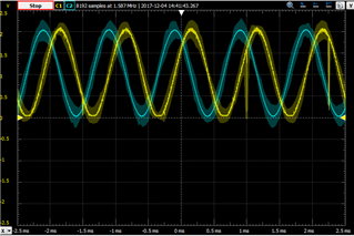

    The picture below shows input ADCBUFFER (blue) and output DACBUFFER (yellow) for an order two high pass filter. The input frequency is 1kHz and the cutoff frequency is 50kHz. The output is not attenuated as expected.
    The picture below shows the same but with the filter order increased to 6.
