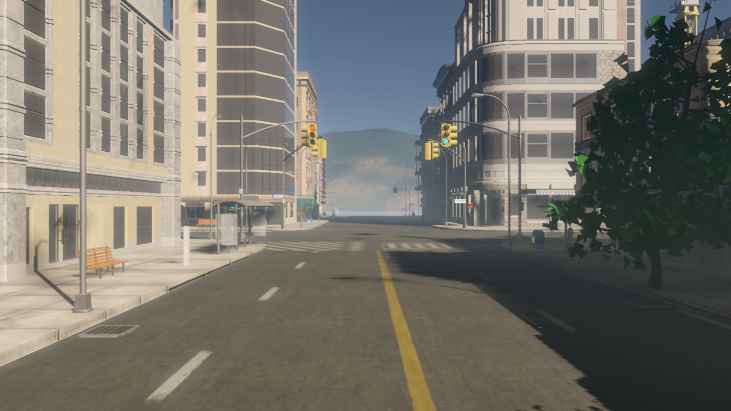

Figure 1: Our test scene without AA

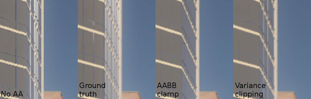

Figure 2: 8x AA Ground truth
The above code will produce the best possible result (ground truth) as seen in figure 2 but that is expected to break under motion. To fix that we need to re-project the history buffer instead of just sampling it in-place. The issue with re-projection is that it creates some noticeable ghosting. There are some solutions that remove ghosting; in this article we will focus on a couple of them that revolve around mapping the history color into the range of the current sub-pixel neighborhood. The first one is to clamp the history color into the bounding box of the current sub-pixel neighbor [Lottes11] [Malan2012]. The second one is called variance clipping [Salvi16].

Figure 3: 8x AA with AABB clamping
Variance clipping as opposed to AABB clamping is configurable. High VARIANCE_CLIPPING_GAMMA gives a better result overall but at the same time the ghosting artefact's are increased. Lower VARIANCE_CLIPPING_GAMMA removes more ghosting but it increases jittering.

Figure 4: 8x AA with variance clipping (gamma 1.0)
Both of these techniques aim to remove ghosting and to some degree they manage to do that quite well. Unfortunately, both of them also introduce some jittering -which appears as mild flickering- when the current sub-pixel color and the history color are very different. One solution is to weight the ModulationFactor using the difference of luminescence [Lottes12].

Figure 5: A comparison of the 4 modes (8x AA)

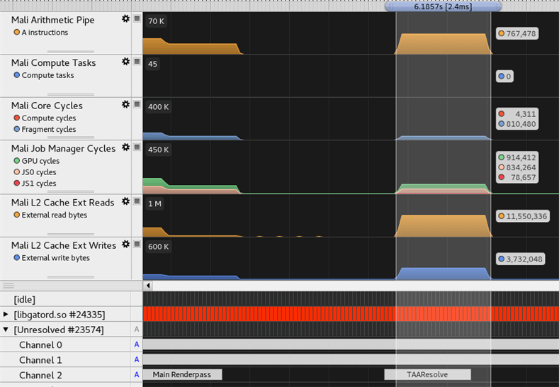

Figure 6: Temporal AA resolve pass in Streamline performance analyzer
Running at 720p on a Galaxy S7 -which contains a Mali-T880 MP12- this pass runs in about 2.4 ms as seen in the screenshot of DS-5 Streamline performance analyzer (figure 6). Please note that this capture was taken with serialized submission to highlight the runtime of the render pass during optimization; in a production build the idle time before and after the pass would not be present.
